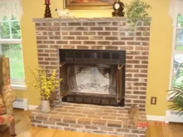

Fireplace dimensions..
- 38 inch widt
- 17 1/4 height
- 15 depth
Mantle Base depth- 21 inches
Mantle Height- 37 Inches
Mantle Width- 41 1/2inches
Chimmeny is steel(14 years old always maintained , very clean, ? guessing a pre-fab kit).8 inch fleu
Cost...well hopefully under 2k?

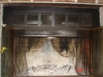

Do you know the brand of prefab fireplace? The low height makes this a challenging one to come up with a solution for.
What say ye gang? I don't find a tiny insert that will work. But would demolishing the hearth, building a new one at floor level and putting a free-standing stove with a liner make it?
The dimensions don't make a lot of sense to me, when I compare them to the picture. If you rip out all the sheet metal on the front where the sliding metal curtains are, and you get right down to the brick opening itself...is that what you're saying is 38" wide x 17 1/4" high? It looks a lot more square than that to me. What's the dimension from the hearth surface up to the first course of brick, which should be sitting atop a steel lintel? (brick to brick...forget about the sheet metal facade). Rick
You might find a freestanding hearth stove that vents through the back to make clearance. It can't bee too big, however, with the size of the slab it would sit on. I bet it's a lot bigger when you take out the sheetmetal stuff.
What is the brick repair for? You may need to think about a liner as well.
I think this is a metal zc prefab with a brick veneer. If correct, what you see is what you got.
BeGreen said:
...what you see is what you got.
Dang, that ain't a lot of room to work with. :-/ Rick
