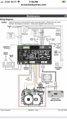

It doesn’t appear to be venting to me. With a venting issue, the flames will “lift” off the burner. Yours are just going out. Here’s the wiring diagram from the manual. In the middle of the left hand side there is a ground wire. It’s probably attached to the bottom of the unit with a screw. Make sure the screw is tight…
Let us know if this helps…

Thanks for the tip. Given the tight space below the unit, I can't see where that wire is attached. I suppose there is some chance that it isn't attached at all.
