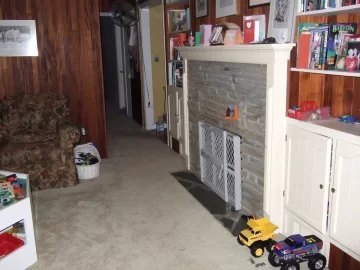

Now about my issue. I have attached two pictures; front view and a side view. As you can see on the side view, the fire place is right where the hallway to the bath and bedrooms is, so putting something in front of it (such as a free standing wood stove) will not work. In the front view picture, you can see the three slots on the left and right, top and bottom. Not sure what they are for, but they are there and make the fascia larger.
Dimensions of the fire place opening are 33 inch wide, 26 inches high and 22 inches deep. As usual, the back is narrower than the front.

Are you looking for a flush fireplace insert due to the hallway? If so, that narrows down the field quite a bit regardless of insert or ZC.
I'm wondering how the heat circulate from this room so that it doesn't become overwhelming while trying to heat the whole house. Do you have a floorplan posted in an earlier posting? Will you still be running the IR in very cold weather?

Looks like a Heatmoor(spelling). The slots are vents where the lower ones take cool air in as the upper ones let warm air out. Small convention loops. Looks like a steel box, which is exact set up I have, cept mine had square holes in brick with louvered vent covers over them. I fit a Summit in mine, but I think mine was a tad larger than the measurements you gave.
Not sure anything that will fit in that firebox will heat you enough on those really cold nights. Otherwise you would prolly be fine. Rather than going enlarging the current fireplace, what about getting rid of it, and making an alcove, then installing a large freestander in the alcove? Summit, BK King, Equinox, etc? Kuma does have a nice large Catalytic insert, not sure if it will fit though.
The fireplace appears to be your best option being it's already there. I would think you would have to go through the logistics checklist of what the project will take, financially and labor etc., in order to put things into perspective before the first portion of any demo happens. You have all spring and summer to get er done. :)

View attachment 65472View attachment 65473
From the following dimensions taken from its specification page, it appears that the Hearthstone Clydesdale could fit that opening. Would the Clydesdale have enough horsepower to heat a 2800 square foot home? Maybe. My Clydesdale heats my 2000 square foot home with relative ease. Ths Clydesdale does have the advantage of having a 2-position flue collar that can be dropped into the firebox as an aid to installation.

A Clydesdale would be too small in this case. At 2,500-2,800 square feet he will need about 3.5 cu ft for the firebox.
The Buck Model 91 would fit if you plan on going with an insert. You will need an 8" liner.

More importantly, what are those plastic trucks in your second photo? Not a single vintage metal Tonka? Raising 4 boys to become good citizens used to involve at least one emergency tetanus shot.
