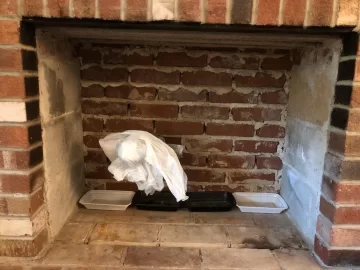

Hello,
When I bought my house 3 years ago, there was an old pellet stove installed. It was pretty worn out and I've since taken it out. I'm looking to replace it with potentially a wood stove insert. The fireplace is only a brick fireplace and does not have a true chimney as the pellet stove just vented horizontally out of the house. The space above the fireplace doesn't go anywhere, it just dead ends a couple feet up.

Fireplace dimensions are W=34" H=26.5" D=18.5"
A wood insert needs to be installed in a true masonry fireplace. This looks like more of a brick alcove. What is unknown is how it was constructed and the amount of masonry between the interior and the surrounding combustibles.
The sides of the opening are made of full size cinder blocks, 8" thick. I'm not sure what's behind those. Above the opening there are cinder "beams" extending the full width of the fireplace and which extend 8" high with additional masonry structure on top. The back wall is just one layer of brick to the outside.
The heat loss in the back of the cavity must be high with only one layer of brick. An insert is designed to vent straight up. Rear venting would require a freestanding stove.

The 26" lintel height will be the determining factor followed by the mantel clearance requirement. The Jotul Rockford F35 with the short leg kit might work, but the hearth would need an extension at the floor level and it needs 20" from stovetop to the mantel.

I’m planning to move forward with the F35 Rockwood. I made some modifications to the mantle and I now have all the proper clearances (with a floor level hearth extension).
With the short leg kit, I will have about 3 inches above the stove to the top of the fireplace opening and the concrete/cinder beams/lentils that span the opening since there isn’t a true chimney above. Do I need to set up any shielding to protect the masonry elements that are close to the stove? Obviously they are non combustible, but I’m not sure if they are fire rated since the original purpose of the fireplace was for housing a pellet stove. Would being 3” from the heat of the stove negatively impact their structural integrity over time? Thanks for any input!
[Hearth.com] Options for fireplace without Chimney [Hearth.com] Options for fireplace without Chimney
If the structure is 100% noncombustible then it does not need additional protection, but the heat losses to outdoors may be high. Will the stove have a blower on it to move heat out into the room?
