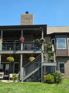

How tall is the current chimney?
BKVP
I'm guessing 16'. It seems 6' to the roof then another 10'. Do you agree?
If the stove in on the main floor with 8' ceiling and the same on the second, plus chimney outside I'd guess closer to 20'. If the stove would be on the second floor, more like 14'. You will find most wood stoves, due to increased efficiencies, need 15' or more, depending upon elevation.

This pic is deceptive. This is a walk out basement so the main floor is the upstairs one in the pic. 9' ceilings. So, you suggest I measure before buying anything then.

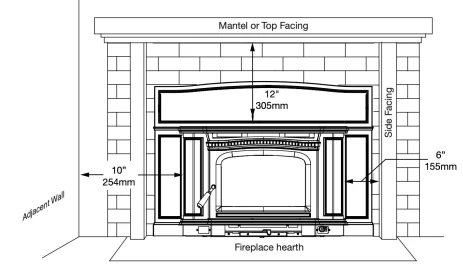

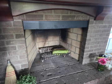

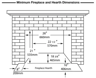

You’ll want to match the insert with your decor, but the Pacific Energy T4 should fit there. The back is a bit narrow, but it sticks out of the fireplace some. Other similar sized inserts should fit too. ~1.6 cu ft firebox.
Agreed, it is not going to take a large insert to fulfill the requirements. A PE T4 or T5 will suffice. It looks like either may fit. A low and slow burner will not likely have much if any flame present so that may not please the wife. What is the width at the rear of the fireplace?
FYI, the clearance to the wood mantel needs to be within the insert's spec. This would be less of an issue with a flush insert, but flush inserts aren't the best for power outages if that is a concern. They need the blower running to convect heat out sufficiently. It looks like there is sufficient clearance for the T5 but always good to check.

I will either raise the mantle or install a non-combustible one.

Agreed, I'd go for a medium sized insert. The mantel may be ok. It's a possible clearance issue for some inserts, but not all. The Alderlea T5 only requires 12" clearance from the top of the insert. Looks like there is more than that here.
[Hearth.com] Adjustability of wood insert [Hearth.com] Adjustability of wood insert
Is this an interior or exterior wall fireplace. The insert will benefit from a block-off plate in the damper area if it is exterior. It wouldn't hurt to put some kaowool or mineral wool insulation behind the insert in that case too.
Check out MagraHearth mantels. Made is Wisconsin beyond real looking!
