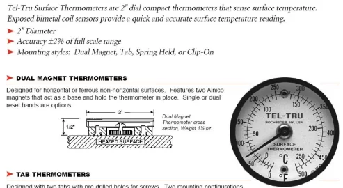

Thanks for the link 3fordasho. Which model Tel-Tru are you using? Where did you pick it up?
I like the Tel-Tru DM-014-750 surface thermometer. It is the first model I've seen with clear black on white markings and a glass cover. That is my kind of stove thermometer. It matches my trusty old Sandhill.
  • [Hearth.com] Fireview Flue Temp vs Stove Temp

Thanks for the link 3fordasho. Which model Tel-Tru are you using? I like the Tel-Tru DM-014-750 surface thermometer. It is the first model I've seen with clear black on white markings and a glass cover. That is my kind of stove thermometer. It matches my trusty old Sandhill.
Tel-tru #4910 02 66 which translates to model GT225 2" dial, 1/8npt thread, 2 1/2" probe length, 200/1000F scale
Thanks. Where did you pick it up? It looks like the local listed dealer is no more.
