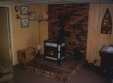

New Fireview install. I've been trying to figure this photo thing out and its a pain. Love the stove, burns great, still stinks after 3rd day of burning.

Goodmorning Todd,
I am looking to purchase and install a Fireview in a new home(I hope) to build in the next 6-12 months. I was looking at the picture of your install and had some questions:
1. What is the clearance behind your stove pipe and the wall? Is that double-wall stovepipe venting out the back?
2. Did you use the recommended size of hearth that Woodstock had listed in their booklet for the Fireview?
The room that I am looking to install the stove in measures 24' long by 12'wide, and I was concerned about how far the hearth might have to project out into the room if I used a rear vent stove(such as the Fireview). Do you have(or anyone else on the forum welcome to chime in)any idea if I could use the Fireview with a pre-fab insulated chimney chase on the exterior wall of this house? I could use the Keystone that would top vent out of the stove, but would still have to go outside for the chimney due to the room above the Living Room.

Sorry I'm a little late on a reply. To answer some of your questions.
Pipe clearance is 10" from wall. Stove sits out 21". It's single wall pipe. The hearth is 61" x 62", in the basement, built against a cement wall. I just went with the same size as the old cement block hearth so it would match up with the exsiting carpet. I put the stove as close as possible to the back wall. I did have to put a pipe shield on the top because of the short clearance to the ceiling. The Fireview has the rear vent only, so because I had to use a couple 90 degree elbows the stove sits out on the hearth farther than say the Keystone would with a top vent. But it worked out good for me, it sits smack dab in the middle.
People say cat stoves don't draft well with outside type chimneys. Maybe that it so with some cat stoves. I talked to Woodstock about this and having 3 ea 90 degree elbows worried me about draft. They told me they have had successful installations just like mine but couldn't guarantee anything. I thought what the hay, they do have a 6 month money back guarantee, so I bought it. My stove drafts better than the Hearthstone Homestead non cat stove I had before. Give them a call, they can answer all your questions.
