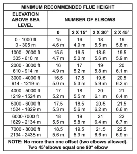

15' is total recommend length at sea level.

This is what my dealer recommended after I gave him all the measurements, what does 15' at sea level corelate to my elevation? I don't recall any chimney heights mentioned in the installation instructions. The only guideline I remember is 2' above any part of the roof that is within 10' of the stack. I'll try to post a few pics tomorrow.
At 5,000' if it's straight up (no elbows) then at least 17.5 ft is recommended in the manual I have.

You are right I just was looking at the same page, funny the dealer never said anything about that and said 12' would be plenty. Thanks for pointing this out to me, so if add some chimney height hopefully the smell will go away. I'm willing to give it a try, just can't hardly believe the draft is lacking but thats about all it could be at this point. Thanks for your input, much appreciated!
The good news is that the additional height should fix the issue and improve stove performance.
