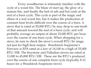

The one thing that I don't understand about calculating btu's, if the stove is rated for 55,000 btu's/hr when ran at its max, what is it rated for when you turn the stove down for a 10-12 hour burn. Shouldn't you be sizing the stove to your house when the stove is coasting instead of it's max?
Your not going to be running a stove at its max 24/7 , right?
The link you provided says you should figure the average output/hr. will be an average of the low/high output numbers, and you should size the stove taking this into account.
I had to read this part a few times to understand what they meant by a burn cycle, I believe what they are saying is if their stove is turned down for a 8 to 12 hour burn cycle you need to cut the max btu's in half, so a 50,000 btu/hr stove really only puts out 25,000 btu/hr when turned down.
I would think going bigger is better so you get the long burn times, if you went with to small and had to run it at max, you would be going through a load of wood every three hours.
If I'm misunderstanding something from the statement below, please correct me if I'm wrong.
Maybe right after you cut the air on a fresh load, it might be, say, 25K, with no flames in the box, just cat burn. Later in the burn cycle when you are down to coals to the point where you're at 250 stove top temp, it will be much lower.

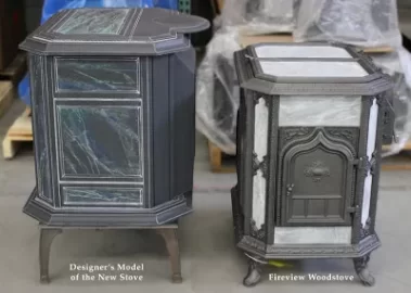

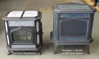

I found these images online and gives a comparison of size between the Fireview & Progress.

The Fireview has no ashpan and isn't designed to cook on (but you could of course). The PH has the ashpan option, and has 3 cooking temps on the top. It also differs as it's a hybrid. Plus it has a much bigger "fireview". Things to consider.
