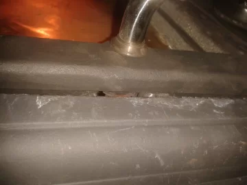

The door isn't closing fully, and as a result, you can clearly see the fire through the gap in the door. I'll put a picture below. I don't know if this is due to warping over time or maybe if the door was never quite right for the unit, but either way, it's inefficient, right? As it always has that extra little bit of air supply coming in and will burn faster than it should.

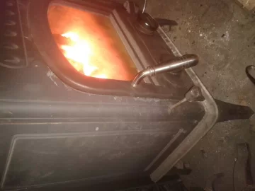

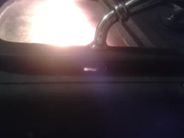

Oh here are a few pictures. The first two just give a general overview but the third one had the flash off and you can see the fire through the gap.

Look for an adjustment in the handle/latch - many stoves can be adjusted by the latch or hinges or both. Really need to address that issue. Not so much for anything coming out with regard to fumes because there is negative pressure inside the stove as long as there is heat in there but you need to close it off for control. Great potential for a run away stove with air leaks.
Wait for it to cool and tell us what you find.

Exactly - heat rises so as long as there is any heat in there the air is going in and up through that leak. In the winter it will always be warmer in the stove than outside so air flow will remain in - not out even when the stove is cool. This is why an open fireplace robs your home of heat.
Runaway means you get it going and the fire and subsequent heat/temp keeps rising to out-of-control with no means of control. A bad thing for sure. Be careful - your family thanks you

Hard to tell from the pics, but is that gap consistent along the door? Or does the door edge touch the stove at the top/bottom? If it's the former, you should be able to adjust it (are you able to close the gap if you push the door closed?). If it's the latter, something may be warped--take a straight edge to the door and the stove edge and see. No, the secondary burn has nothing to do with the direction of air flow. Keep in mind that that gap isn't much different than just having your primary air control open. Like others said, I'd be more concerned about that stove getting too hot and not being able to control it. So no, the gaps aren't safe. And btw, that stove actually looks pretty efficient...

The secondary burn and what is being burned was formerly going up the chimney on older model, less efficient stoves as "smoke". The gas is just smoke, vapor and some other stuff but really what the stove is doing is re-burning or actually burning smoke. If you can smell smoke in the house there is back flow. Now there are times like opening the door without opening the air etc. where a little smoke smell gets in the house but I am talking about continuous smoke smell and visual evidence during the burn.
For some peace of mind try holding a lighter near the door crack while the thing is swirling on the inside and see if the flame gets sucked in or pushed out. It will be sucked in and you will know the direction of flow.

I see what you're getting at nola mike. The gap is not consistent all the way along the door. It's only at the handle side that it's not flush with the body of the stove. Starts out fine on the other side, and gradually comes away from the stove as it goes towards the door. It's almost like the door wasn't fitted properly, as I don't think the heat I'm generating would have warped it. I'll check the stove and doors with straight edges when I get home. Thanks.
Nice tip on holding a lighter close to the door BobUrban. It's put my mind at rest, so thanks for that.
