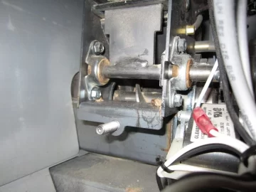

While were here...
A before shot of the convection fan. I am really surprised
it's not full of dog hair.
[Hearth.com] First 1 Ton Cleaning - XXV
Last shot before the back panels go on.
