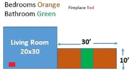

So I bought a very lightly used stove in September of last year the original owner used it for 2 months for supplemental heat in his double wide while they waited to get enough money to replace their furnace. He doused it in wd40 to keep it from rusting. A little weird I know but I assembled the piping and burned a good fire in it to burn off the WD40 before installing it at the end of September. Unfortunately I wasn't able to fire the stove again after install until this weekend.
Now here is my concern. I know everything is installed correctly BUTTT I didn't get a chance to fire the stove in its new location. The outdoor temps are supposed to be around -1*F with 10-20 mph winds and am concerned with the stove heating the cottage. It is 960 sq. ft. and the stove is rated for 1200 sq. ft. and 68,000 BTU with hardwood. Do you think I will have a problem heating the space? The insulation is brand new in the walls R13 and in the R19 in the ceilings. Below is a layout of the cottage.

The insulation seems a little on the lite side for the ceiling, typically in your climate area r30 is the number to shoot for, I take it that this is a weekend home? If it is, do you keep the heat on during the week? If not you may have a few uncomfortable hours getting the house up to temp with the stove, but once it hits temp you should have no problem maintaining it.
*remember while running this stove full throttle burns send more heat up the chimney, you may want to find that point on the stove were you have full secondary's going but not the air fully opened, good dry wood is a must, if you don't have dry enough wood I would pack long underwear and a good jacket for this weekend.
Yeah the insulation is light mostly because it was built in the 90s as a summer home. I don't have any supplem ental heat other than a couple electric heaters. I planned on stoking the fire in the middle of the night I am hoping to keep her stocked well throughout the night with the little electric heaters helping. My FIL said I should heat with only those little duraflame electric heaters but I highly doubt they will keep up compared to the wood stove. I have wood that is 20% or less moisture that I am planning on burning this weekend. I plan on using the little electric heaters in the bedrooms to help get everything warmed up. I do have 2 ceiling fans in the living room to help circulate the warm air down. I am hoping after a few hours it should be good for the weekend I don't mind tending the fire every 4 or 5 hours.
Once everything is up to temp furniture, appliances, ect do you think it will keep the house warm enough to be comfortable? I planned on the living room being about 80 with the rest of the cottage around 65.

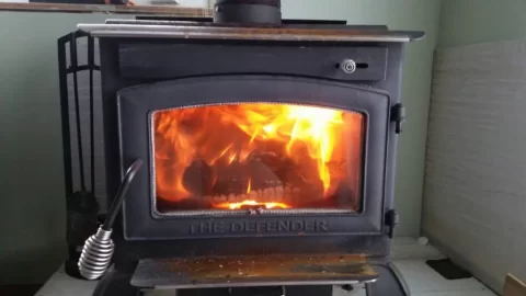

I taped over half of the air inlet only because the air inlet control (what I call the damper) wasn't allowing the secondary to do that slow lazy flame it looked like I had the door open still (see attached photo that is without the tape)[Hearth.com] First Burn in Vogelzang defender

A couple of things...yes, a blower will typically lower the stove top temps. Completely normal. Second - run the stove as designed until you know it inside and out. Cutting the primary air down is/was probably part of the reason for lesser heat from the stove. Don't think that the rolling river of secondary flame needs to happen from light off to coaling. Guessing - you rushed the stove into secondary flame without allowing it to work through the initial outgassing (which looks just like your pic).

Pretty easy stuff, really. On reload simply open the primary air full open until you are starting to get close to operational temps on the stove top and then start to decrease the air in a couple of steps. First to 50%, then 25% then to the final stage to allow for a nice long cruise. Often times, this IS NOT FULL CLOSED. It would not be unusual if you needed the primary to remain 5-10% open, but this is where the learning curve comes in. Ya just gotta work with it until you understand how it is going to react. Leave the fan off till you get an established stove/fire/temp.

Yeah I was doing that but on fully closed that is what my photo shows as a slow burn. I always thought when you fully close the air off it should start to choke the fire out in the case of an overfire/chimney fire. I do remember on one of the fires I left the door open to ensure the wood had caught with a fresh load of wood. Next time I will try the way you descrtibed and see if that will make a difference.
