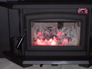

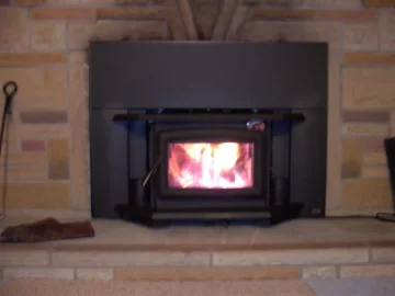

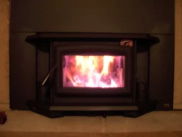

It finally got into the low 50s upper 40s this week in NE Ohio. The first three nights I cured the paint and the last two I've had decent fires. I started out with the thermometer on the door and the top and after reading some posts moved it to behind the door. Last night with temps. around 52 using soft wood (I think cottenwood)and filling maybe half full I had temps 750 -775. This is much higher than my VC Dutchwest ran (by about 250). If I run this high on softwood what will happen when I use hardwood and the outside temp is colder and the draft improves. I seem to have good draft now but if you look at the last picture you can see the coals that remain after 8 hours with 3 smallish softwood pieces loaded at night. If I had too much draft, wouldn't the fire burn out quickly?
Comparing this to my VC the PE is so much easier to use and secondary burn is easier to achieve. If I'm correct in my obsevation, if the PE would get too hot, the correct thing to do is open the air??? This is opposite of my VC. Why is this?

Soft wood tends to burn hotter and faster then hardwood. Hardwood releases its heat slower and lower.
Looks like you got good secondaries and a good long burn there. It's hard to say if your temps are too high since they are taken on the front of the stove, but you have no other options for taking temps. How hard would it be to take the surround off and take some stove top temps temporarily and compare them to the front face temps?
as long as you closed your air all the way down i wouldnt worry ... stoves get hot!! now if it stays at 775 for a couple of hours (3-4) start worrying... or if the stove starts glowing... most of the time it will get those temps with good dry wood but then it starts to slowly come down

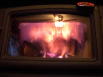

2nd pic [pinkflame] looks like unburnt CO to me= if it had enuff combustion air it would be more blue= slightly inefficient but nothing serious ithxnx
I think the pink flame is more a combination of camera flash and cheap camera. The flames were more orange and blue.

where he has it on the stove in the third pic is the best place for pe inserts
