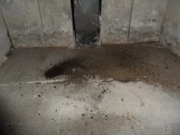

Hello all, I decided to use the Soot Eater for the first cleaning ever on our new set up. We've been trying to burn 24/7 since mid November and have a Jotul f400 Castine with a 16ft vertical flue.
Before I started I had about a Cup of loose flakes on top of the baffle that had fallen previously.
Using the Soot Eater I think I got about 2 cups more. See below for (possibly poor quality) before and after photos. It didn't get everything and didn't make it shiny like a brush but I don't think there's any more loose stuff. And it doesnt really look like any glaze on the way up, hard to tell though.
Does that seem like a reasonable amount of buildup? It also encompasses some less than ideal burns which will hopefully be reduced with our learning curve.
On closer review of the pictures I could probably have gotten that first section of double wall pipe cleaner though...
Thanks!

I see stage II in that plastic bag, you either have wood close to 20%, burning temps a little low, or loosing to much heat off your stack (possibly from single wall pipe between the stove and class a chimney) Either way you right on the line or cusp, keep an eye on that chimney, inspect it after every cord or so of wood is burnt.
Good on you for thinking to clean mid season like this ( maybe we’re not quite at mid season yet). I’d try to get that section cleaner, like you said. If it doesn’t clear up with soot eater, perhaps a chimney brush (poly brush) might help. Don’t want to say if that a normal amount or type of buildup because Im not a pro. But at least wanted to give you the input that I fell kinda confident about.
looks good to me, I'll be doing that to my chimney today as well. Furnace is running, stoves all cool, just got to finish my coffee and crawl up there.
Your either smouldering your burns, or burning wood that is not dry enough, or both.
Should not have that much black flakes(usually from the top section), nor that much after an entire season.
Yes, the top pc needs to be cleaned better.

My stove says to run between 400 and 600 degrees, and I'm usually closer to 400. Should I try to keep it nearer to 600 all the time? My wood moisture is in the mid-to-high teens. I will occasionally use a fatwood to start a new fire, would that cause it?

You should burn within the recommended temp, that keeps your house at a level of warmth that suites you.
I would try and stay mid way to higher end, or inspect and clean the stack periodically to avoid issues.
Fatwoods ain't going to cause that. What species of wood are you burning, and how long has it been split & stacked prior to burning it?
We've been burning a mix of maple and Ash that has seasoned for a few years, and some standing dead wood Ash that I recently cut but moisture content measures in the teens on a fresh split face at room temp. I'm wondering if it's temperature related. We have 9' of Class A above the roof to get enough height for our stove.
I cleaned from the bottom up so that picture was looking up. The pipe that didn't get as clean is the section of double wall stove pipe.
Sent from my SM-N960U using Tapatalk
If that is the bottom part with the heavier coating, I stick to my guess of either wet wood, smouldering/too low a temp burned at, or both. The lower part is the hottest, and should not have that kind of build up on it.
I do have an in line damper, but I've kept it wide open thus far. The odd part is that the class A cleaned up easily with the Soot Eater, whereas the double wall stove pipe didn't get as clean
That is because the stainless of the class A is very smooth and does not rust as fast as the stove pipe. The stove pipe has a surface more conducive of the soot & creo having something to grab onto.
