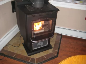

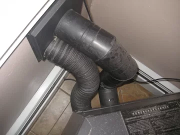

this is pix of my setup...
not sure if I would have to pull stove out. less room than it looks..

No, I mean on the outside? Is there any verticle rise to it? If there is, you should have a clean out T at the bottom. Either way, you shouldn't have to take apart any of it to clean it properly.
if your reply is to me, this is my outside.
