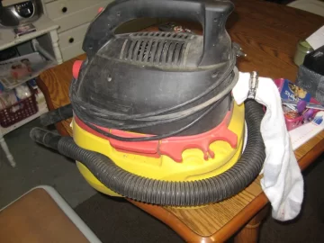

btw; picture of my homemade ash dust catcher..
Cheapie Home depot 2 gal shop vac.[sock is extra].. like it because it's light and hauling a 5 gallon shop vac in/out is silly for me due to the small amount of ash I will suck up. Besides, most of the ash get's Brushed into the Ash pan which get's hand emptied anyways...
