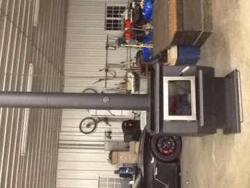

Here is set up in my man cave. 24 hours of burn still going! Amazing!

I'm hoping you never have a fuel line leak in the car...
Me too, the car is much further away than it looks in the picture however. 15 feet or more. Also building is 3500sq ft. With 14 foot ceilings lots of air space. Back and sides of Stoves has heat shields on it.
Did you check with your insurance company about installing this in a garage? It is against code in most jurisdictions. Even where permissible they usually require the stove to be installed 18" above the floor.
Begreen makes a very good point Carl. When I installed my stove, the insurance agent said it could not be installed in my garage. I never intended doing that, but he mentioned it just the same.

They allow them where I live but I'm not sure what specs you have to follow.
I have the same stove in the house. With 3500 SF did you consider the King model?
I am installing a stove in my shop this week and my permitting authority (county) requires it be 18" off the floor. This is actually a good thing since loading and viewing will be easier from the more frequent standing position of a shop. Plus, the explosive gasses thing.
I do have to switch insurance companies though. State Farm will not insure an outbuilding with a stove.

It is the King Ultra Model. On pedestal. I live in NoMans land, way out. My dog allows me to set my own codes out here. However it was done by a licensed BlazeKing dealer and Chimney Sweep. Thanks for the warnings though

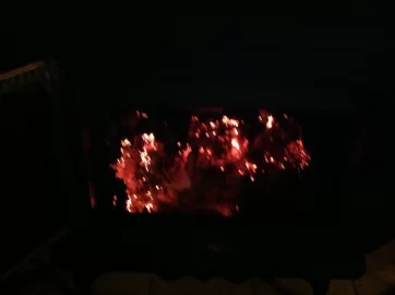

Mine is at 26 hours right now with plenty of wood left. I'll probably refill in the morning. Un freaking believable stove.
Reactions: alforit
After 35 hours...still had a split off to the right that had a ways to go and lots of chunks Still solid. this doesn't look like much left to a non-cat burner, but it would have probably made 40 hours and it wasn't exactly a packed load. It was bur oak though.
