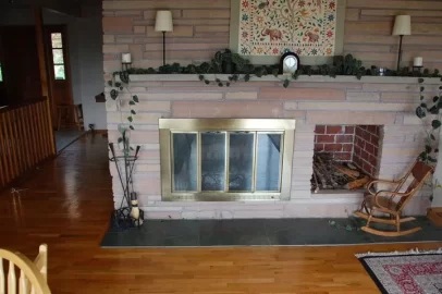

I am still split on the blower issue. I can see that there will be times I'd want it. What do folks do about the cord? I saw one thread where someone bemoaned the fact that the brochures don't show the cords, and I am so glad, because I hadn't thought of that at all. I am not the sort who wants to run conduit up through the downstairs ash dump and install a special switch to meet code. If there is an ash dump, which I am not sure of, it's probably behind the gas furnace in the basement.
I wonder if it's reasonable to drill into the firebox from the wood box, and run the cord through the hole, then run a tan colored extension to the nearest outlet, which is about mantle height on the right side.

The cord is an issue but after a while you don't even see it. The rolling flames and warm gentle breeze makes you forget pretty quick.

My cord used to run through a hole in the floor to a receptacle in the basement but I found that is a no-no according to code. Changed it when I put the new floor in few years ago

As to your cord. I'd mount a recpticle in your tinder box, then cut or drill a hole through to the firebox. The morso has ports on either side to route a cable/cord through. This is what I did.
