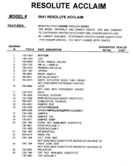

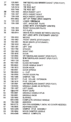

I have an Acclaim 0041 with shaker grates which needs the lower fireback and arches replaced as well as the retro fit brick upgrade (metal sides craked where bolt goes through). Should I be looking for the original arches and fireback, or will the current parts fit? Secondly- I can't seem to find info on the retro fit kit- I have the parts explosion for the 0041 but the only info it has listed for the left and right core sides is "not available- substitute on page 76"

I think you need to go a pretty complete rebuild on this thing, and then the new parts may end up working....although parts list still shows old parts because some people may not have rebuilt theirs!
Over the years, things have changed with this model since they used to offer (and still may) a "repair or upgrade" kit with all the proper parts to retrofit.

Any up-to-date service manual from VC should mention this exact situation.

Well it sounds like the whole interior upgrade kit will run me in the $350 range. It's a lot, but considering I didn't pay anything for the stove it not too bad. The kit includes a bunch of stuff including all new arches, fireback, interior sides and I'll have to replace the exterior sides too.
I pulled the stove apart (removed lower fireback and arches) this past weekend to check out the combustion package. It didn't look too bad, but I'm not sure what I am looking for either. Can anyone clue me in? I didn't notice any big chunks missing- all of the holes were the appropriate size... Should I just go ahead and replace it anyway? I think it's an additional $140...
