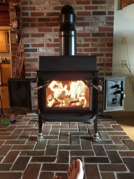

I just fired up my new to me Grandma for the first time. It’s about 55 degrees outside. Figured I would do it while it is somewhat warmer outside incase it smokes and I need to open the windows. But no burn off smoke or fire smoke at all. Really happy with it.

I think that's the first I've seen ball feet sat inside bear paw feet. Those forward facing paws are cast iron which may hold the expansive forces, but the angled feet which are die cast white metal would not be strong enough.
The bear feet came with washers to set inside for leveling. I'd remove the original ball if possible. Are the studs welded to stove legs, or screwed into a nut welded on leg bottom?
I measure 5/8 inch clearance to bottom stacking quarters inside foot.

The studs are welded to the stove legs. I tried to remove the balls. They have a set screw to hold them onto the stud but the set screw kept stripping and I did not want to cut them off. The brick floor is uneven so rather than just have the balls with leveling washers exposed underneath the balls instead I used the feet to hide the washers. As you said about the 5/8 inch space, that’s filled with washers. Each ball sits on a stack of washers, not the sides of the feet.

That's good. You wouldn't think anyone would abuse a set of feet like that, but you never know!
You can only soak those set screws with penetrating oil and drive a small nail or punch into the Allen hole, or use a punch the size of the set screw to pound it inward. I found Kroil and time as being the best penetrant. This loosens the threads and they turn right out. Much like a bolt in a threaded hole that you drive inward loosening the threads. After a few smacks, the correct size Allen wrench should take them right out.
Tapered legs look goofy with the bear feet anyway. You may have started something new!
