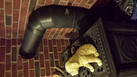

1. I currently have a coal/wood stove(CoalBrookDale_Darby) that is being replaced with a pellet stove. I have a brick chimney that the 6" stove pipe connects to. The new stove has a 3" connection for the pipe, I would like to know if I can just use an 6" to 3" adapter or do they make some piece that connects to the 6" hole in my brick chimney that reduces the hole to 3" that I can run the 3" pipes from the stove? I also seen 3" kits that run pipe all the way up the brick chimney or maybe someone has another idea.

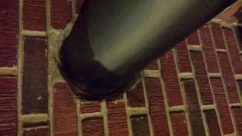

I suppose it's better than 65.00 lol But Like I said I don't have a thimble thing in my brick chimney. Thanks Mike

So the larger end will fit right inside my brick part of my chimney? I don't seem to have a thimble thing, my stove pipe goes right inside the hole in the brick.

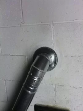

this is what I did with the end cap... it goes into the thimble, which goes into the chimney...[Hearth.com] First Time Installing new pellet stove
so your stove pipe goes all the way to the chimney... does it just slide out to replace it?
this is what I did with the end cap... it goes into the thimble, which goes into the chimney...View attachment 163946
Yeah, my pipe just slides about 4 to 6 inches inside the chimney, I saw a video of a guy hooking the thimble thing up to an outside wall, I'm wondering if I could just use the same thing and screw it into the chimney?

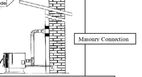

This is a pic from the manual of the stove I'm thinking about buying. As you can see the oak goes in the bottom of the chimney. This pic may be on the outside wall, mine is on the middle of the house with the clean out in the crawl space. If this was on the outside and it had a clean out on the outside it most likely would be closed, I'm just thinking how much air could this stove really need if it was using this install method. I'm sure I have a good amount of air in mine. Oh well I'm sure I will think of something.

This is just my interpretation, only.
I think that OAK illustration shows it on the side of the chimney...
Not in it.
I'm sure someone will chime in if I am wrong.
