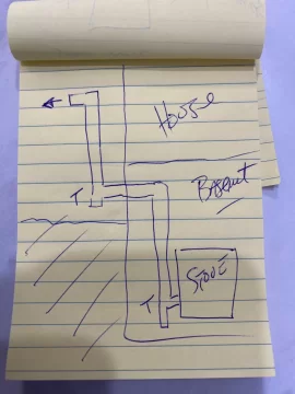

I will be cleaning my 4 inch vent pipe for the first time. Johneh has me set up to buy a brush set at PAuto.
My tee's (2) have cleanouts. Not sure what they are like. I think you take the cover off. So now I can easily clean the
outside as a tee is there. For the inside there will be a tee behind the stove. Should I try and run the brush inside
from the outside? I don't think that is possible unless I disconnect piping. That means I will need to run it up the
pipe from the back of the stove, but not sure if the cleaning poles would make the bend. Worst case I could use rope
and drag the brush. How much crap would be in their anyway?

I picked up my new brush cleaning system. The rods are somewhat flexable. Do do the inside properly I'd have to unscrew the slip joint portion
which is at the top with the 90. Only other way would be to attach the head with a rope and pull it through. I'm not sure how dirty it is as this was my first year.

Thanks for the info. I hadn't planned on the leaf blower trick, but I will try it before cleaning the pipe.
I think I will leave all the joints together to start with, and try removing just the tee caps. I have one of those
inspection camera's which may help. Plus if I pull the cleaning head through and nothing comes out, there can't
be much. I think I remember watching a guy use the drill/brush/rod combination and he went from the outside past his 90 and down to the stove. He was doing it from the side of his house standing so his stove was probably in his basement. I'd have to take my outside tee off
though.

Here is what I think I should do based on the replies:
Clean the stove's inside
Clean the stove exhaust pipe past the Cblower and ESP manually - maybe remove ESP first.
From the outside take the tee off - clean the outside vertical portion
Use the rod cleaning kit to go into the house portion all the way to the inside tee
Empty the inside tee using the removeable hatch.
LBT - To suck any remaining dust out
Cover the outside to prevent humid summer air from getting in
I would like not to take the tee off but it's the only way to introduce the cleaning rod.
At least the inside tee all stays together, and that is harder to get at.

I think I could do it with the ESP in. I might take it out this year as I never had it out.
Well I really don't want to take the outside tee off, but I need to so I can get a straight angle to clean the pipe in the
house. I have never had even the cap off. Mine has the silicon gasket. At least if it's only taking the tee off outside I have
plenty of room. I think the LBT is good as it draws all the dust out from the stove too. I might just try the huge shop vac I just rebuilt
and stick the hose in. I get the filters cheap from Amazon. I don't want to ruin the shop vac though.
