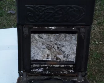

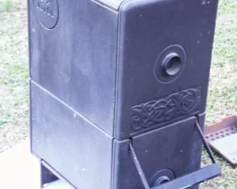

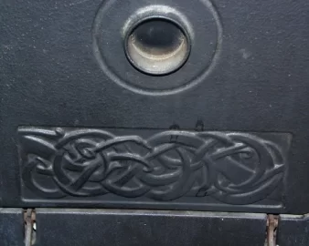

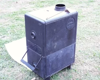

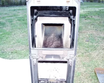

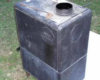

Here are some pictures of my stove. I think what I am going to do since I can not locate a manual is just go with the standard three feet wall clearance and add a spaced backer board so I can cut that clearance to 1.5 ft. I will then use a double walled pipe through the ceiling and attic and add all the usual standard attachments for stoves. I am excited about this stove. Even though it does not have the nice big viewing glass I think it looks great. Next step is to clean it up a bit and make it shine. I still appreciate any tips, advice, or encouragement. Thanks.

Hello Warrior,
Congrats! A real nice stove.
If I were you, I would search all Jotul websites including European stove sites for information, manuals, specs. on your stove. Contact Jotul USA directly and some old time Jotul dealers. Then give it a first class cleaning and inspection for open seams, cracks and gasket checks/replacement. Looking also for ID information, SN etc. on it. Then the paint/polish of your choice.
I would max out your clearances on the install, as heat shields were not spoken in Norwegian when it was built. :>)
Let us wood burners know how it is going.
