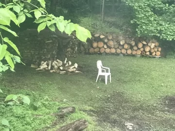

Hey folks, I’m in the process of installing my PH from Woodstock and cut and split what I imagine would come close to three cords of various wood types such as pine, oak, cherry, elm and probably a few others. It’s all stored together. I had stacked it in the traditional cord style 4x4x8 raised about 8 inches off the ground, however we needed to move this pile and when we did my wife had done a Norwegian style? Which I guess is circular and I very much like the appearance of.
My main question is about how to stack and store wood effectively to ensure low moisture content. How long must I store wood that was dead on the ground when I buzzed it before it can be used for heat? Is it acceptable to be stored with different varieties together? Currently I’ve got tarps covering the pile but not expertly done and could surely do a better job.
I tried attaching pics to show what I’ve got so far. My intention is to at some point build a wood shed but doubting that will happen til this fall if not next year as I’m currently rehabbing the cabin on this property I’ve bought in the woods. I appreciate any and all advice or resources or books, just want to be as educated as possible since my heat will be exclusively through my PH near central PA.

Ideally in full sun with a breeze with no move than two logs deep. Ideally swap the tarps with solid covers. If tarps are all you have put pallets on top of the stack and put the tarps over the top of the pallets without covering the sides of the pallets so damp air can readily flow out from the top of the stacks.
Unless the wood has been drying for at last a year and you have stacked perfectly you have a tough winter trying to burn less than dry wood. I hope its a very small cabin used on weekends as the amount of wood looks marginal for 24/7 burning.

To dry fast you need to split smaller and stack single row top covered with good sun exposure and air movement. Or you could do a solar kiln. The way you have it stacked I would expect 3 years with the oak probably 2 for the other stuff.

Now with what wood you have and the way it is stacked to me will be to wet to use the way it is stacked now. One way to tell if you wood is ready is get a moisture meter and test a FRESH split with the inside running with the grain , not on the end of the wood. 20% and down is what you want. Get ahead 3-5 years and you will not need to test wood. Even dead wood will still be to wet to use, some of the top limbs will be ok ,but trunk and large limbs will not. Some people top cover and some do not.

Also, that location in the photos looks very shady and damp. I don't know if wood will ever dry deep in the forest like that. Do you have any clear area?

What I can see is the piles are up against the woods. But can't see the exposure to the all day summer sun. That's what you need. Due to all the humidity I top cover all year. You will be burning this next winter, because it's all you have. It will blacken the glass, and will be better in a year or two. But nice looking stacks.
Like others have said stack it off the ground single row and cover the top, leave the sides open, but you have to get it out of those Holzhousen piles and spread it out to expose it to sun and wind; if you get years ahead then stacking it in the round would be okay but it is like a pile of wet clothes, it won't dry properly unless you take the clothes out and hang them one piece at a time on a line to dry lol!
I would stack it so the first woods that you use are the standing dead and then the Cherry, the Oak will take the longest to dry and the other stuff in between. But depending on how much dead and Cherry you have you might be okay for this Winter IF you find a spot where the sun hits it most of the day as well as the wind. And if you can scrounge some Silver Maple and get that split that dries fast too, good luck and keep us informed on how it is going but break those piles down now into single rows in the sun and wind as that will give you your best chance at drying in time (except for the Oak).

I’m a PH owner. My stacks are set up in 3 parallel lines about 12” apart with great exposure to wind and sun and top covered with tin. My first year felt great, but after my 3 year supply became truly seasoned, my understanding of ‘great’ has changed dramatically. Dry wood really makes a difference in running a PH. I’m guessing you will end up feeling somewhere between unimpressed and very frustrated with your wood this season based on your drying set up.

The farther you get the firewood stacks from the woods, the better. Sun and breeze, as other people said.
