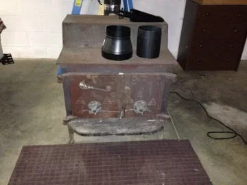

Looking to get this wood stove recommissioned for our basement.
This will be in a basement with no floor and just a concrete slab. I have heard these units get very hot, since it will be on the slab only, is there any reason I would need to have a hearth underneath the stove?
We had a serviceman out to check the wood stove and chimney upstairs. When he was here he quickly looked over this unit and said it should be serviceable as long as I made sure to install the piping correctly. That being said is there anything I might want to look at in detail particularly concerning this unit.
Lastly, does anyone have any pictures of what these looked like originally? If this unit works properly I would like to get it refinished and use it in the basement for the foreseeable future.

Well to start get rid of that magic heat and what is that reducer for that is sitting on the stove?
That reducer and a few other parts were here when the house was purchased that has been their home since then.
I am redoing all the piping from the stove to the chimney as advised by the service expert who briefly looked it over

No i just warned you that reducing a stove by 2" generally is not a good idea and will hurt performance. Then you said you were going to go from a 10" vent down to 6". But i totally agree there is no need for any hearth protection
It's an upside down increaser. ;)

This model was before the Smoke Shelf Baffle was added. So adding one is going to raise efficiency.
This model also has an 8 inch outlet for the ability to burn with doors open and screen in place with less than optimal chimney.
If the OP has a 6 inch insulated chimney, and is not concerned about the regulation that does not allow reducing the flue size, I'd estimate his fuel usage around 5 cords in the north, more like 3 in North Carolina.
As bholler mentioned above, reducing is generally not recommended. However this stove was designed with the larger flue outlet for Fireplace Mode burning. The square inch area of firebox is no larger than the Papa Bear with 6 inch and physically works fine with 6. There are many in use reduced, and even reduced with a baffle installed. Here is a thread with video in post #28. https://www.hearth.com/talk/threads/cant-seem-to-figure-out.119184/page-2#post-1617042 This is a double door Fisher with baffle added and 6 inch chimney that does not smoke when doors are opened.
Another example is the special built "Great Grandpa" made the width of Grandpa, and Papa Bear depth. The Fisher fabricator built it with 6 inch outlet.
So there's no doubt that a normal Grandpa will physically work reduced with a proper drafting chimney.

The reducer - As far as I can tell this was to incorporate the Magic Heat, which I am getting rid of (hopefully someone on Craigslist wants it). I am going with only 8" piping. Hopefully this will help me thwart the Gestapo.
As you can tell from the previous pictures this unit has a rear outlet, and I definitely want to make sure I handle this correctly.
The outlet sits 22.5"-30.5" off the floor, my thimble is ~63"-71" from the ground. If I understand what I have read correctly then I will need to have a 45 degree elbow from the unit connecting to a 45 degree elbow coming from the thimble, then piping connecting the two. Please correct me if I'm wrong

Two 90* elbows are fine. The solid corrugated ones are the best. The damper goes in the first straight pipe within easy reach. If the material behind stove is not combustible, clearance is not a problem. If combustible wall, 18 inch clearance to single wall pipe is required or 6 inches to double wall close clearance connector pipe. Clearance to the stove from combustible wall would be 36 inches or reduced 66% or as close as 12 inches with approved heat shield.
With 8 inch all the way, I'd certainly look into a baffle. This thread is retrofitting the single door stoves with one similar to what was used in later Grandma and Grandpas. They were designed for smoke reduction and preventing excessive heat from escaping. They do a great job of reducing smoke which can lead to a cleaner chimney.
