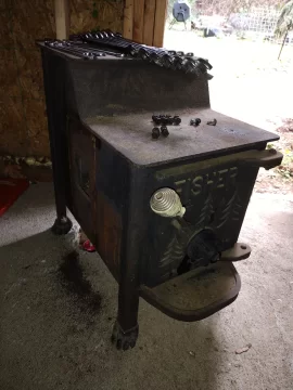

Hi, new member here. I have a question about my early 70s era Fisher Baby Bear wood stove.
A couple years ago I picked up a Baby Bear stove. The stove has a flue mounted on the right side, and a pellet hopper attachment on the left side. There is no side or rear flue collar.
I have two questions. Did Fisher sell these Baby Bear models with a side exhaust/flue? Or has mine been modified?
Similar question about the hopper attachment. Does anyone know if Fisher sold an optional pellet feeder hopper for this stove?

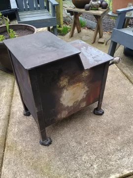

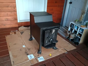

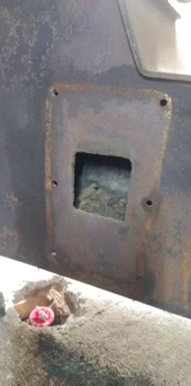

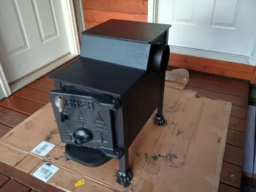

Here are a couple of photos before / after. The holes left over from the deleted pellet hopper are now welded up, and the stove has been sanded and painted with hi temp stove paint.
