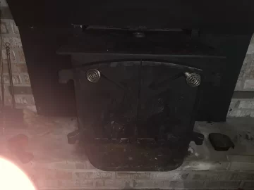

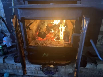

I moved into a house last year with a fisher insert not sure the year. I used the wood stove last year and had trouble keeping the stove regulated temperature wise . The stove top temps would run around 400 to 800. I had a couple times it went up to 900 with the air intake completely shut. The stove has a 8 inch chimney liner connected to it. I can’t put anymore than a piece of wood or two max without it getting to hot . Is this normal for these stoves ? Any info would be greatly appreciated.
Here are pictures of the stove that I have if that helps at all.

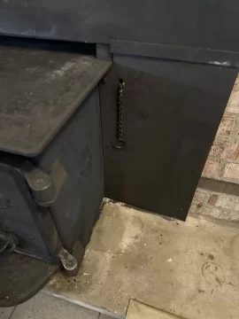

Does the Insert have the factory damper at outlet? There should be a lever or chain control through slot at right of Insert through fireplace faceplate, I can’t see it in pics.
Yes, a baffle moderates temperature spikes and is the best and easiest modification you can do.
Everything points to an air leak into firebox. You should be able to control the fire closing air intakes down to a glow with little to no flame depriving fire of oxygen. (Not a good burning practice)
Wire wheel the back side of doors at sealing area. This is the raised area and grooves along side of it. (You can remove doors easily to wire wheel with drill outside to prevent dust in the home) Also scrape and wire wheel the door seal clean. This is the channel iron welded to stove front. This will make a 3 point seal all the way around door. The raised area on doors will contact the center web of channel iron, and the edges of channel iron need to make contact on back of door.
Light stove, and using a match shaken out to create smoke, or incense stick, go around the door seal area to see if the smoke rushes into the door seal. If so, flat gasket material made for installation of glass can be cemented flat in the door seal channel. You can test fit for gasket using a strip of cardboard in door seal first to make sure you have clearance between door and seal for gasket to allow doors to latch properly. Worn hinges plates, door hinge pins, or improperly welded hinge plates all contribute to air leaking around door seal. The latching handle angle looks correct, so it’s not door latch adjustment.

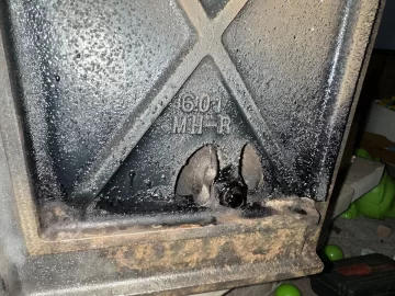

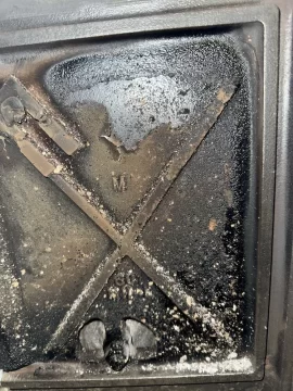

I’m burning my fisher insert and I installed the baffle plate . I also installed a thin gasket on my doors to seal them up better and it does work like a new stove. My only problem is the doors on the inside seem to get build up with thick tar creosote. I’m having to choke the stove down on the air intakes to 1/2 turn or less during burn cycle because I am getting stove top temps over 600 degrees at times. Is this normal ? I’m also closing the flu damper to about half close to 3/4 closed .

Everything sounds normal except the deposits on doors and that much water in Ash.

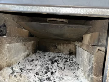

How large is the baffle plate? From rear, how far forward does it extend? Is it flat? How far from stove top, or what is the opening height above it?

I keep my wood stacked off the ground and the top covered with a tarp but I did notice more moisture content than normal for ash . A lot of it is really punky. My baffle that I installed is 19 inches long and I angled it up to about a 3 inch opening from top of stove . I can shut my flu damper and still open the doors and no smoke in my house at all. Is it still ok to close the flu damper with the baffle plate installed . I noticed I have a very strong draft with my chimney it’s 35 feet high and straight up . The liner is also insulated.

Can’t explain the deposits on doors, other than cooling them below condensing point, but I would raise the front of baffle to the minimum outlet square inch opening to match chimney square inch diameter.
Deposits are from water vapor condensing on a cooler surface. This allows smoke particles to stick. The water vapor is from burning the hydrogen in the fuel, not necessarily from the moisture content in the wood. Oven dry wood contains 6% hydrogen. The molecular ratio of hydrogen to water is 9. So burning the hydrogen creates .54 pounds of water for every pound of fuel burned. 25% moisture content adds another 1/4 pound of water to every pound of fuel. The condensing point is 250°F, so below that critical temperature, water vapor condenses allowing smoke particles to stick.
Smoke particles and water forms pyroligenious acid. Primarily wood alcohol and acetic acid. In liquid form this is harmless. When allowed to bake on the surface, this becomes the various stages of creosote. If the fan is blowing cool air on the doors this could reduce the temperature below the condensing point causing the formation. Blowing into the bottom slot under the firebox will remove the hot air from around the back, moving it forward out of the upper slot. This also removes the heat from the hottest area of the stove around the outlet. The baffle is designed to reduce that hot area at the exhaust, moving it forward to the stove top.

Yes, I would raise the plate at front. Start with the minimum opening matching the chimney flue square inch. I think your Insert is 21 wide outside, so 20.5 inside would be about 2 1/2 opening. Not much difference, but you’re doing it to change the angle to allow faster flow rising upward in the firebox, possibly scavenging the smoke away from doors more. Every venting system is different, so you can only try, keeping track of the burn characteristics with changes. The areas you see any formation is where there is stagnation, or little movement or turbulence of the flow, usually in corners.
How far from the doors are the log ends? I would try a few things and not be too concerned about it. As a coating of soot can build up, keep it scraped off occasionally since it has a high insulating value.
