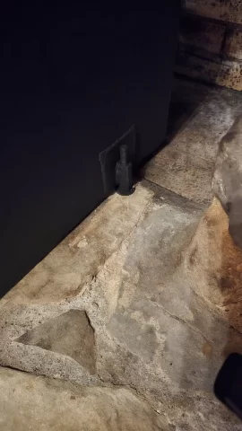

[Hearth.com] Fisher Woodstove insert[Hearth.com] Fisher Woodstove insert[Hearth.com] Fisher Woodstove insert[Hearth.com] Fisher Woodstove insertQuestion: i am installing a Fisher woodstove insert and noticed it only has height adjustments on the back. Are these inserts designed to be installed so the bottom of woodstove is lying flat on the floor? Or is it good/ok to lift it up a little? I know there is cold air intake on the bottom front of the stove that wraps around to a hot air radiation on the top. Appreciate it.
The whole thing could be raised yes you will want a filler panel under it as well. And you are planning on a full insulated 8" liner right?
I have to do a 6in insulated liner. The opening where the flue was coming out of the fireplace is 7in...filler panel under it? I have the 3 panels to go on sides and top
That stove requires 8? What size are the clay tiles in the fireplace flue? If it just the damper area that's to small make it bigger.
And yes if you raise the whole thing up you will have a gap under the stove and will want to fill that area with a metal filler strip
Good information, thank you...If I go with a 8 I have to bust out brick. I am gonna do a 6in insulated 316Ti liner. Use a reducer from 8 to 6 coming off the stove
