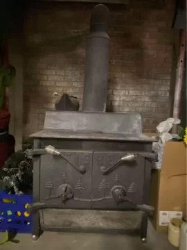

I got a a grandpa yesterday after loosing out on a mama and papa that sold instantly after being listed.
I jumped on the grandpa within an hour of the seller listing it. I paid big bucks and had to pull it out of a basement.
I paid $650, which was more than the seller was asking.
It was in pretty good condition with the original fire screen but the screen had the wrong latch installed that wasn’t secured to the screen, the latch was a modern truck camper latch.
The stove needs new firebricks but otherwise in good condition. The seller also gave me some chimney pipe. The pipe that comes directly off the stove is a straight pipe with a damper and reducer that goes from 8 inch to 6 inch. Also got three 6 inch two foot long pipe and a 6 inch elbow. A metal ring that covers the hole where the pipe goes through the wall an old poker, ash bucket and old kettle.
I definitely paid two much considering it needs new firebricks but I got tired of dealing with shady sellers who promised to save the stove for me but sold it out from under me. It was tough to find a good old fisher in central Kentucky that is in decent condition and when they pop up I recommend to jump on it, beg the seller to sell it to you and pay them over asking price.

Here is the stove that I got.
