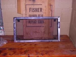

Coaly, do you have the dimensions for the fire screen? Is anyone reproducing / fabbing these.?

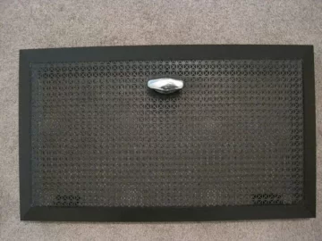

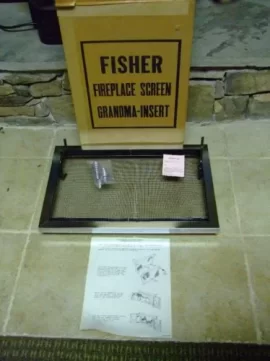

Grandpa or Grandma? Flat top doors or arch top? There are "time period correct" and rectangular common style with chrome frame. (shown above called "Contemporary Style" - Black is "Classic") Grandma also fits Goldilocks, Teddy and full size Insert.
You CAN use a flat top door type screen on any stove, but you can't use a screen for the arched top doors on a flat top door model. The rectangular older type had latches on the screen to hold in place. The newer style for arched top doors sits on the hinges. The hinges are not spaced correctly on the flat top doors to hold the new style correctly.
New ones are not being produced. Let me know which one you're referring to and I'll give you measurements if I have them. I have the part numbers for most too. They were made by different manufacturers for Fisher, so what was used by different fabricators varied.
Here's a thread that shows the styles and what happens if you try a new style on a older stove with flat top doors;
https://www.hearth.com/talk/threads/fisher-grandma-stove-needs-a-screen-insert.102936/
CamFan may still have some if you're looking for Grandma. (Contemporary Chrome)
[Hearth.com] Fisher sand instead of sandblast?
Door opening in inches;
Grandma; 17 wide X 10 1/2 high.
Grandpa ; 21 wide X 11 high
Screens vary by style for instance; Grandma chrome measures 19.25 wide X 12.75 high.
The black style measures 18 wide X 11.5 high.
Black 23 x 13. Chrome 23 X 12 1/2.
They come up on eBay from time to time. They also sell for close to $200.

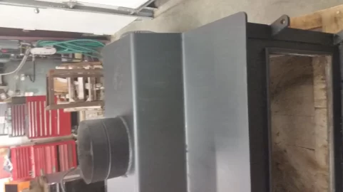

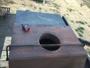

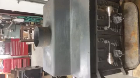

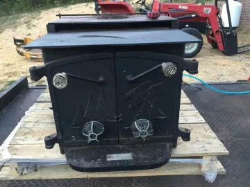

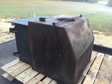

Would you guys sand blast this or sand and paint? There is some pretty good rust in some areas that would not come off with a wire wheel/brush. Most of the rust appears to be on the top of the jacket that was in the fireplace and behind the fire bricks in the back of the stove where the insert was "slammed".
I was able to get some of the packed on rust off of the back of the top trim piece by hitting it with the air chisel. I just hit it until it was flat/smooth again.
Would you guys use an air chisel to get rust off the inside and top of the stove or is that a bad idea?
I am very excited about installing this and I want it to last for ever! Appreciate you advice!
I would scrape what is loose by hand and wire brush, then paint.
Just scrape anything loose inside. No paint there.
Keep the draft cap threads and hinge pins greased and it will outlast you.
