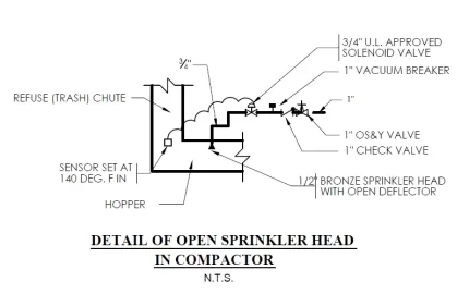

Several of our communities require sprinkler heads in the mechanical room. I've even seen some tied into metal chimney, but I have no idea how those worked. I know the waterline had no water in it until it released somehow. Similar to dry systems in commercial.
What you are referring to as metal chimney with heads in it are most likely trash chutes or linen chutes.
By code there have to be sprk hds in them on alternating floors. They are fed by a dedicated riser and the open head in the compactor is controlled by a solenoid vlv.(see the attached sketch) [Hearth.com] FLAME DEFENDER
