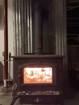

Hi all, I have a Jotul Oslo V2, interior insulated chimney about 25 ft tall. On a full load I get flames for about 2.5-3 hours and maybe some very light wispy flames for another hour and then I’m basically in the coaling stage for another couple hours before a reload. I can go about 8-9 hours and still have enough coals to get a fire going in the morning. One thing I cannot seem to achieve is a slow roll of secondary burn when burning a full load. On a small to medium load I can achieve that., but on a full load of oak/maple I get the gates of hell and then when I turn down I get what the video below shows (1/8 open on the air) and if I go down anymore I risk choking the flames out. My flames always seem like they are going “fast”. Do these burn times and flame sound normal. It seems like I have too much draft, but on the other hand I still have the ability to choke it off.

My limited experience has me guessing that your mid-smaller load sizes are limiting your fire from taking off. Perhaps with the larger load start incrementally lowering the air sooner?
Seems like you have to much secondary air coming in to me, the primary flames at the bottom are slightly strong (if the video is with the air cut off all way) the secondary seems to vigorous. I'd have the draft tested on this unit with a manometer that will determine if a key damper should be installed.
I have similar flame/coal times on my similar setup (tall, internal chimney). I have tremendous, good draft, no key damper, just the air intake adjustment damper on my US Stove 3000. When I bank it up for the night, though, I leave wide open until it gets temp up to 400-500, then choke down for the night. Usually don’t reload during the night for to laziness, but just stir the coals in the morning and throw a couple pieces in and takes right off... haven’t noticed a huge amount of difference between when using oak, hickory, or ash for the flame times...

With the fire shown in the video, it does not look like closing down the air a bit more is going to risk choking the flames out. That looks like a normal fire for when one is trying to produce heat, but there is room to get the flames lazier.
That seems a little too vigorous. There has to be an in-between setting from that to dead. You say you still have the ability to reduce the air. Do so.
In that video the air is almost all the way down and if I do go all the way down, all the fire goes away on top and the result is some light flames on each side of the wood. Makes me think it is just smoldering, will even get a small amount of smoke from the chimney when its burning like that
at night I usually put two large splits at the bottom and then fill it up with medium size splits. When I get my chimney cleaned this season I will ask if they can measure the draft
