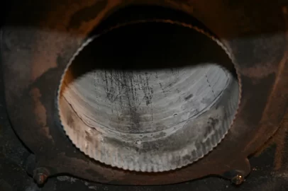

Has anyone had any issues with their Flex King Pro liner coming apart? I cleaned my liner for the third time and looking up from the stove connection I could see a piece of the liner pulling apart creating a 3 inch wide flap. This would probably be a place for creosote to collect correct?
Should I be worried about the flap? Is their anyway to fix it?

Berner:
Your liner problem doesn't sound good. No, not a good thing at all. How far up the liner did this defect occur?

Can we see pictures?
Possibly what may have happened is the inner layer, the smooth wall may have been "grabbed" by the brush being used and when pulled up it could have bent a layer up. These liners are sensitive. It is not just the Flex King Pro, it is any liner made of the same construction, any company. If you put a decent dent on the outside of the liner during the install, it will create small imperfections on the inside. This does not make the liner unsafe at all, its not like it has a hole in the liner, it is still completely safe.

I think that is exactly what happened. I brushed the liner from the top down and when I went down to empty the container attached to the bottom I noticed this.
[Hearth.com] Flex King Pro
This is still considered a closed system so like you said it's still safe to burn. However I'm nervous that it is going to collect creosote and ignite. After doing a little test with my creosote I'm now paranoid about burning my house down. I took the 4oz of black powdery creosote to my outdoor fire pit and lit a match to it. It ignited without the slightest hesitation and spread throughout the entire pile of creosote. I can only imagine what introducing the amount of air (draft) that is present when burning a wood stove.
What do you guys think, is this a rip out and replace?
My experience, and that of others, is the inner coil gets puckered when the liner is uncoiled for installation. Then the pucker just sits there waiting for a chimney brush to hang up on it and pull it farther out.
Oh, I see, yeah, I had a few of those "scales" pop up like that, like BB said, it happens when they coil it up, then it stays when you uncoil it. Or it could be your brush caught it, but even if it did, it was likely sticking up some from the get go.
I have the Flex King Pro too (8")
I guess that wouldn't bother me too much at this point. Is it where you can reach it? Maybe, tap it down LIGHTLY with a small ball peen hammer? It is obvious from the pics that you are burning pretty clean, so there is no stage 3 creosote to light off, lesser creosote will burn too (amazing that you got it to light so easy, I have done that and it took A TON of heat to light it off. Like throwing it on screaming red hot coals) but it is pretty hard to get it to light off. It appears to be loose from the bottom side? That's good, no liquid can pool there...
This issue does not happen with the Flex King Pro. As you can see the rest of the liner does not have any issues what so ever. Maybe other companies have this happen.
But as you mentioned it is a closed system with no safety issue. You installed it correctly, eliminating any possibility creosote would build up there. As mentioned try tapping it down with a small hammer and let us know how it turns out.

I am not saying it can't happen, but it doesn't happen to every single liner. And as seen from the picture of the liner from the OP, that was not done by coiling it and the rest of the liner is perfectly smooth. My point is that you can not say coiling automatically makes all the fins pop up.
I'm a little confused. Is this not supposed to happen with the Flex King Pro?
Should I expect this to happen more and more the more I clean the liner?
James nobody is saying it makes them all pop. But some is too many. All of a sudden when you uncoil it that smooth wall, ain't. It isn't any surprise or anything new. Mine did it in 2005. Everybody's inner strip smooth wall liners do it.
If it wasn't a common problem I seriously doubt the urge to develop the new HD smooth/single wall liner would have come about.
This is not supposed to happen. What happens many times is the liner will get a dent in it from the outside, this may happen during the handling of it during the install. That dent causes a little lift on the inside layer of the liner. Then when you brush it with an aggressive brush this may happen.
Would this be considered a warranty defect?
A defect if the liner becomes dented? This is the nature of the liner, the inner layer has the possibility of raising slightly if dented. There is no defect in it. Just as a single ply liner can kink on itself, especially when made oval. Not a defect.
