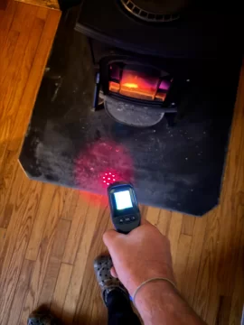

[Hearth.com] Floor protection for Aspen C3[Hearth.com] Floor protection for Aspen C3[Hearth.com] Floor protection for Aspen C3I can take some readings if that helpful. I haven’t had to run hard yet this season. Right now I’m 450 flu temps. Sometimes I’m close to 700 if it’s running hot. That’s a big difference in temps though.

Hello! Thanks for your post, and I've read almost everything you've written about your Aspen :)! We're just few days away from installing and will add as much front floor coverage as we can fit. If you are able to take a reading of the floor 18" in front of your stove that would be amazing (but if not, no worries at all). Many thanks! Sara S.
And a ps - I just saw the images - thank you for taking the readings. I'm not able to see the temps in the photos, alas - do you have a sense of how hot it is running on the floor? Thanks!
About 90 in those pics. That was just warming the house back up after being gone all day.
I’ll take some more readings when the stove is cooking, but I suspect I won’t see it much over 100 if that. The warmest spot is usually about 4’ from the glass door.
I’d bring out the protection as far as you can though. 2-3’ or more. You’ll be dropping and spinning logs on the linoleum as you play Tetris to fit them in, gouging the softened floor from the heat. At times you have to scurry around to rearrange burning wood as you work the coals and load the stove, or need to adjust a load to get it to settle. Sparks and embers will jump way out the door and you’ll need a spot to lay a hot iron if you’re struggling with a load.
