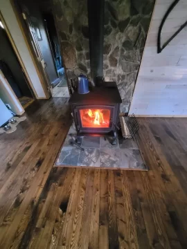

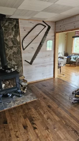

When I bought my place it was a real mess I ripped out all the old disgusting carpet and installed this black ash wood floor,I used a darker wood stain and 4 coats of minwax poly,it's held up decently for 10 years now.
Maureen B.
Aug 4, 2023
14
29829
That looks beautiful, Marty! We used that type of stove placement in Colorado and it worked great. Given our present house's design, we can place the stove in the middle of the house and depend on it entirely for heat. But being in the middle of the house, it will be in a high traffic area which is why we want to have it on a pad that is flush to a tile floor. I know this will sound strange, but where we really want to use wood is on the ceiling to cover up the popcorn ceiling that is there now. I have a feeling that there is a multitude of sins under that popcorn. Thank you for sharing the picture of your beautiful stove set up!
