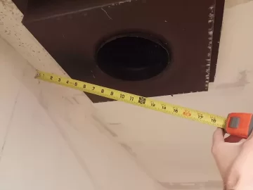

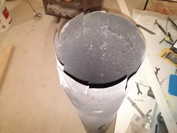

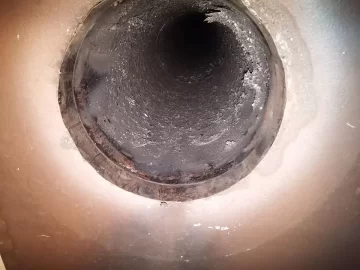

Here is a picture of the original pipe and ceiling attachment. I'm assuming this is a single layer pipe, not satisfying code at all. It is much too close to the wall.
I'm slightly leaning towards all new class a 6" chimney and a new stove with a 6" collar.

I like that you are considering a new stove. It could be that you can use the existing chimney with double-wall stove pipe connected to it. What diameter is the ceiling support box pipe set up for?
The chimney needs cleaning so it would be worth it to have the chimney professionally cleaned and inspected by a certified sweep. If it's in good shape then have the sweep identify the brand of pipe used so that you can get the right stove pipe adapter and double-wall stove pipe. Just remember to honor the stove clearance requirements too.

The ceiling support box pipe is 7" I believe. I'll have to check when I get home.
