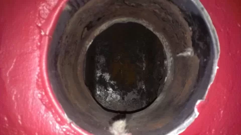

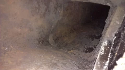

Here, finally, are a couple pictures. Best I could do with my phone...
The first is the view in from the outside, the second is looking upwards. [Hearth.com] Flue Liner - company says it can't install - are they right?[Hearth.com] Flue Liner - company says it can't install - are they right?

With Cracks in the flue tiles like the pictures shown you could probably go through your insurance to pay for the project as they were most likely caused by a chimney fire. In response to the posts you should not downsize the chimney liner size from the size of the stove outlet. You would need to have a company remove the tile liner in order to get the properly sized liner down the chimney with the correct amount of insulation around it.
