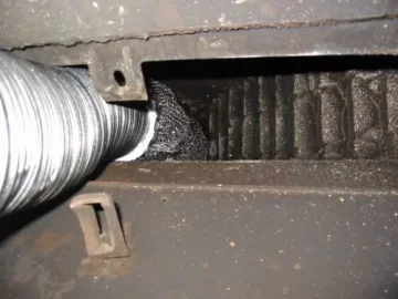

Here's two pics of my flue and liner.we had two oval the liner to get it threw the flue hole.the flue measure's 6" across and so does the liner.is it ok to do this??????the clean out tee will be up close to the flue when my short leg kit comes in.
If its not ok to run the liner round to oval to get it threw the flue is there an adapter to use and if there is where can i get one.
or would you use a block off plate???
Thank you john.

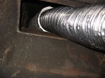

heres another pic

Looks so clean. Could've cut off that tab that's hitting the liner, but otherwise, there's nothing wrong with it. You'll have to fabricate a block off plate. I made a cardboard template first, then steel. Went much easier.
Thanks Granpajohn!! A little encouragement goes a long way. I would like to keep the tab there to be able to keep the fireplace working when and if we move.
I have the original block off plate for a template. I tried to get it installed by a dealer but i was told next summer with a giggle.
Like i said it will get cut off(the liner) close to the flue and the tee with clean out will be connected there.
John
