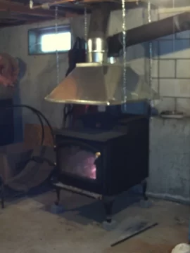

Begreen, My chimney has pulled from the house (footing problem). I am having the whole thing knocked down and rebuilt so I have my choice of flue liner. At first, I was going to use an 8" cylindrical flue tile thinking to accommodate a Blaze King to replace my cracked Quadrafire but Blaze king states if I have more than two turns in flue direction, their stove would not have acceptable draft. I have three and their all 90* So now I'm looking at just getting the replacement 5700 Quadrafire is giving me which I'm not thrilled about as they have made the burn box smaller and I hear the stove does not throw out the heat it used to. The chimney is just as critical as the stove so I wanted to do it right as I also liked the Drolet Tundra furnace as no matter what i get needs to be put in the unfinished basement. Everything else is calling for a 6" flue.

Why the 90's? I see a 90 at the wall, a Tee, but after that no 90's are really possible. What's up?

Can you post a picture of the current setup in the basement? That will help us see the connector setup and we may be able to suggest an alternative.

I added the picture above. My stove cannot be placed directly below the thimble as the oil furnace is in the way hence the offset and the extra elbow.
