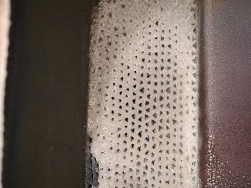

Hey everyone long time lurker but new to the forum.
I have a Hearthstone Green Mountain 40. This is my first epa stove and so far we love it with one exception... The cats keep plugging up with fly ash. Over about a month and a half time frame the cats will get so plugged up when I engage them it will basically put the fire out. My fix has been to cool down the stove and gently brush the cats with a soft paint brush to unplug them. Works like a charm but I'd rather not have to do it with such frequency because we burn every day and I don't like to let the stove cool down!
I have a clay lined flu which seems to draft really well (it will blow out a lighter if held up to the flu pipe) and the stove seems to operate perfectly when the cats are clean. My wood is primarily red oak at 20-23% moisture content (per my General tester on room temp splits) and has been seasoning for about a year, I know this could be better but we just moved to this house a year ago and I'm still building up my wood program. I do not burn paper (or anything but wood) in the stove, I split thin kindling and light with a propane torch.
Is this avoidable? Is it because my wood is only a year seasoned? Is this normal for a HearthStone? Any advice would be appreciated!

Generally in the morning, I scoop out excess ash before loading more wood. The ash is still quite hot and yes lots of fine particulate goes flying. I never connected the dots that the fine stuff is going up into the cat! It's also flying into the room which is not so nice.
Think that could be the problem? If so what is the solution? We burn a lot and sometimes build the ash to the point where we can fit wood into the stove.

All too common with these fine steel cats and their tiny holes. Brushing the face of the cat doesn't clean out the cells though, are you able to vacuum those cells clean? Like any filter, the more it plugs up the faster it plugs up.
The stove design is based on a specified draft strength. If you exceed the specification, then things like this can happen. Being over or under the specified draft is something worth fixing.
I am able to vacuum and usually do, however all of the buildup is on the outside face of the cat only, the interior of the cells stay clear. I verified this the first time I had the issue by brushing that powdery fly ash off and then pulling the cat out and sighting through it to make sure it was flowing.
How does one adjust the draft to make sure it is within the specs of the stove? Also I don't see a specified draft for this stove anywhere in the manual, would I need to contact the stove company to figure that out? Non of the chimney companies around here seem to be very helpful all they want to do is cleanings and pass the buck and say its the stoves problem. When I contact the stove dealer they say its a chimney problem.. ;lol
Most stoves specify 0.04” to 0.06” of vacuum in the chimney at high burn. The professional installers should have a device called a manometer to measure the draft strength but honestly it’s not usually done unless there’s a problem.
If draft is below spec you can add chimney height or insulate the flue to increase it. If draft too strong as you seem to have the common solution is a key damper.
