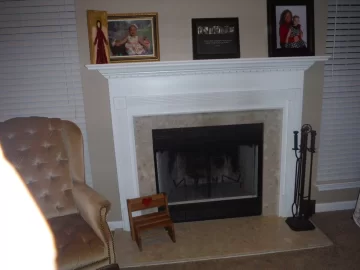

Hey Everyone,
Newbie here looking for advice. We have just purchased a new home that currently has a prefab which I believe to be an FMI 36" bungalow. We are wanting to convert it using a wood stove insert to gain efficency. We are looking at the Buck Stove 18 or the Regency I1200. I prefer the Regency for BTU output, but have seen pictures of the Buck 18 installed into my existing prefab. First question is has anyone installed either of these two into a 36" prefab?
The next question is covering the vents of the existing prefab fireplace. I have seen photos with them covered with the Buck 18, but have read with he Regency the top existing vents on the FMI should not be covered. I have found nothing about the bottom vent. The house is 6 years old and has an existing double walled 8" pipe. Plans are to install a 6" stainless flex tube down the existing 8"
This is a link to my existing prefab: (broken link removed)
and I also posted a pic of my existing prefab.
Any help is greatly appreciated.
