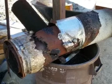

BTW, the enclosed pic from one of our users shows triple wall pipe after too many years.......might give you some idea of why another liner is needed.
Another word of caution - even if you get a permit or check with your insurance - be aware that these people often do not know a lot about pre-fabs. There have been stories here about inspectors walking in, nodding and signing off.
It's YOUR life and property. Although it it difficult to know from afar, I think the experts here will agree that you have too many problems to fix. The only real fix is to remove that unit, carefully check the fireplace and install an approved insert with a new liner.
