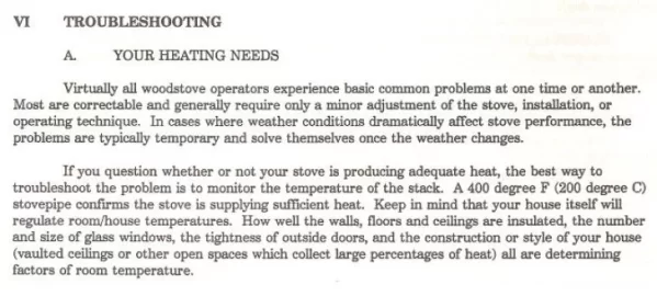

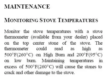

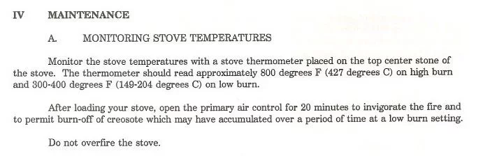

I have the 1st generation Phoenix, (8610 model vs. current 8612) I snipped the operating info from it and attached it below. For my stove it says the stovetop can be as much as 800. I included the section from the 8612 manual which shows that over 500 is overfiring. Interestingly, both manuals note that a ~400 degree stovepipe thermometer temp is sufficient for most heating needs. That is what I do. On high burn my stove top is just over 525 but the flue temps are around 400-425 using a magnetic Condar. I'll be switching to a setup like BB's this weekend with the probe in the flue.
I'm wondering if the older Phoenix had thicker soapstone or a different baffle assembly? It seems like a big discrepancy between 800 and 500 for stovetop temps. MSG might know.
