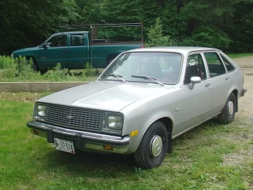

I just solved one of my fossil fuel crisis' with the purchase of a sweet 1980 Chevy Chevette. 36k original miles, one owner, no winter driving ever, 4 on the floor, marketed at 43 MPG when new...I'm up to 30 so far with some tune-up work pending. This solves the problem with my vehicle fuel consumption...now I need to solve the problem with my heating system!

OK...that's enough to get em going. - Check out the Vette!

Some of my best adolescent memories happened in a 1980 Chevette!

Nice find on the Chevette!

I've owned the car 3 weeks...in that short time I've decided that that EVERYONE in America who was old enough to remember them has (had) a previous relationship with...or in a Chevette! Enjoy those memories! (by the way...I found the car in Wiscasset!)
Hope you keep the Chev in the garage come wintuh. Maine roads would love to chomp on that one. There are various clearance issues with side ( power ) venting. Mostly related to fumes being exhausted into windows or vents above. I would have a local certified sweep check out your existing chimneys and get a price to line one for your new boiler.

Willman...I've got bad news...that poor Shove-ette is doomed.
That gray, solid substance in the form of a rectangle behind her car IS my garage and won't be protecting anything just yet...too many projects. In addition, the overly complex spreadsheet I used to justify the purchase in the first place says I'll need to drive it in the winter or the payback will come too late. I'm going to look into another undercoat before snow but don't know if they even do that anymore. I've got very mixed feelings about driving it in the salt as I come from an antique Ford family and to drive a car like that in the salt is a horrible sin...even if it is a Chevy! (if it was a Pinto...I probably couldn't do it!)
So I may have to vent it higher than the lowest window...which on that end of the house is 1st story only...I'd better get a pro sweep down here. Is a good sweep qualified to answer every single question I might have about what I'm trying to do here?
