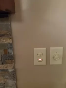

We installed an FP30 arch over the fall and have enjoyed using it so far this winter! Not getting as long of burns as I would've hoped, but still getting a good ammount of heat out & learning the ropes of it. Our blower was also making the occasional squeaking/rattling noises at certain speeds, but adjusting the blower speed seems to help.
Attached is a picture of the final install, and a close up of the switches - which I thought turned out pretty nice. I just used a standard rotary fan speed dial to be able to turn the blower off & adjust speeds, and then a pilot light switch to force the blower on when I want, or switch it back to 'auto' temperature controlled mode. The LED below the switch turns on whenever the fan is running, and off when it is not - that way I can quickly visually tell if the blower is on or off. Sometimes if I turn it down low or if the humidifier or TV is on, it can be hard to tell if the blower is actually on otherwise! I also usually turn the fan off when reloading to keep from blowing ashes around, so it's another good check when I'm sitting on the couch to make sure the blower is back on.

Hope that helps

Hope that helps
