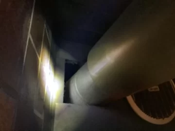

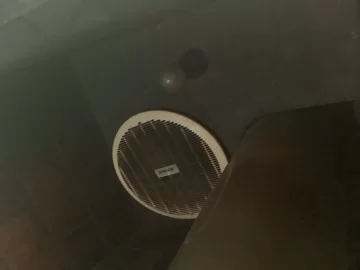

Based on this there may be a flaw in the flue system. Describe the flue system from stove top to chimney cap, in detail. Does it transition from the stainless steel stove pipe to clay liner in the chimney?
Thank you for your message begreen.
The flue extends the full length of the chimney. There is a “bend” in the flue that is not visible. I’m attaching a couple of photos taken of area directly above the fuel stove as the flue extends into the chimney. An extraction fan and light are fitted there. The bend in the flue is not far above the board the extraction fan and light are mounted on.
  • [Hearth.com] Franco Belge model 3707 - water under ash tray.  Any ideas please?
