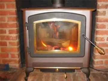

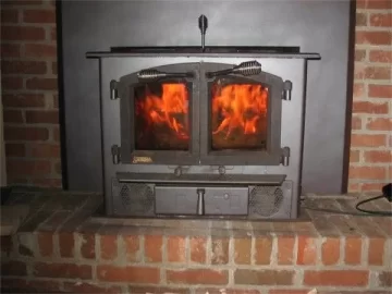

I had a monster insert for 21 years and last year replaced it with a free-standing stove in the fireplace. I will never go back. With a block-off plate above it to keep the heat from traveling up into the chimney masonry the sucker heats many times better than the insert did. Additionally with the free-stander brickwork of the fireplace holds more heat and releases it after the stove burns down.
If you get a free standing stove for it get one that aims the air from the blower straight out across the top of the stove into the room. The heat generation can't be beat by any insert with fans that I have ever seen.
Here are the old insert and the new stove in the same fireplace:
  • [Hearth.com] Free standing stove in fireplace - good or bad idea?
