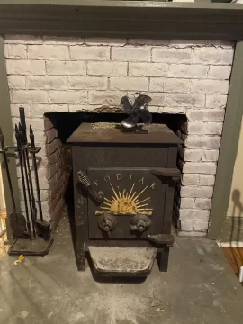

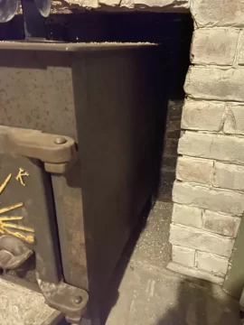

Hi, my family just moved to the Northeast from much warmer lands and we have found ourselves in a bit of a predicament. We purchased an early 1800s brick farmhouse which we discovered has exactly zero insulation. It is essentially a tall narrow box, with a stone foundation for a basement half underground, the main living floor, the bedrooms upstairs and a steep attic. There are two staircases that go from the main floor to the bedrooms, one from the front door and one from the back, meeting at the middle of the upstairs hallway. Not including the basement or attic, the home is approximately 2,000 sq ft. The only operational chimney is interior to the right side of the home with a straight chimney up through the attic. There was originally a matching chimney on the left side of the house, but no longer. Now to the tricky part: the previous owner ripped out the oil boiler and radiator system that was used to heat the home and installed a Heat Pump. Apparently she discovered that a heat pump didn't actually work below 40 degrees to heat the home and she jammed an old wood stove in the remaining chimney. We were told this heated the house. It was July, we had no idea. Nevertheless, we promptly discovered our first winter that it does not, in fact, heat anything past the three feet surrounding the stove and one bedroom above the stove that has a grate warming from the stack.
We would not like to freeze half to death again this winter and would love some recommendations for our situation. The local chimney place sells the Alderlea T6 which is great and that I really like... however stove would have to be deeply inset into the chimney like the old clunker we currently have. I understand the T6 will have a blower which will help warm the home, but we frequently have no power here, up to a week, due to this small town not having a good grasp at maintaining power lines apparently. Also because it must be deeply inset, the cool little swing out wings will not open and I cannot use it to direct-cook on the surface in the event of a power outage.
The other option I have considered is the Jotul F500 V3 (NON-catalytic, I just don't need that stress in my life), with a blower. I understand there are some great reviews, and some less than great reviews. But it could be installed using the rear-entry and sit further out onto the hearth so that in the event of no power, we have better natural convection and can also use the top for some cooking.
Also concerned about all the heat shooting upstairs duet the staircases.
I really thought the Vermont Castings were beautiful and they also have rear entry, but I was told to stay far away from VC. Attaching a couple of pictures take right after the chimney company did an inspection so there's fallen vermiculite everywhere and ash.
Thank you so much in advance!

That's a small opening. What are the fireplace dimensions?
The T6 has a much larger firebox than the F500, but I am not sure it would fit and agree that it would be buried in that fireplace. Have you looked at Woodstock stoves? Their stoves can be rear-vented. Maybe consider a Progress Hybrid or Ideal Steel.

I will have to go measure the dimensions of the opening again, but the T6 does indeed (barely) fit according to the company who came out as this is the model they suggested and that they measured for. I just really worry about being set back and not having the functionality of the swing out top grates. Thank you so much for suggesting the Woodstock stoves, but I am pretty set against a catalytic model at this time and it appears those are both catalytic stoves if I am reading their website correctly.

Would a jotul f45 or f55 work in that space?
Yes, all cat stoves from Woodstock. Good ones but still cat stoves.

I have a similar hearth and am installing the Jotul F55 that I am rear venting. The hearth opening is 29” high on ours and we opted for the short legs option so it will work well. It’s non-cat as I wanted a simple stove for my wife to operate as originally was going with the Woodstock Progress Hybrid.

It appears the f45 would be undersized. The f55 would be better suited however it is sadly about 1/2" too tall if any portion must sit in the fireplace at all. The hearth pad extends 34.5 inches from the wall and the F55 is 24.5 in deep. I am not sure if that is too little amount of hearth pad left.
Your issue though sounds like there are other issues with the house itself. Is the heat pump a mini split? If so and it’s fairly new then it should operate down to -15 to -20 albeit efficiency is much less. Also depends on whether proper sizing was performed as one compressor would have to be beefy for that house and layout plus you would need several inside wall mounted units. Also what are you doing about insulation?
SHORT LEGS you say? I am looking around their website and not seeing this option. My fireplace opening is 29.5 in tall so VERY similar to yours. What portion of the stove do you intend to have sitting in the fireplace itself without sacrificing radiant heat? Will you install the blower kit with the F55? Thank you so much!
Yes short legs are available. They cost an extra $140-150. My plan for the hearth is installing a block-off plate in the chimney and also plan to install metal sheeting painted black behind the stove and partially on the sides. This will all be attached to the current brink and painting it black will make it kind of disappear. This will help reflect the heat back into the house and hopefully prevent the masonry from soaking up all the heat. I am not planning a blower and instead will have a fan on the floor blowing cool air towards the stove plus also have a ceiling fan set to suck air upwards and back down the walls in that area of the house. Our first floor is mostly open concept and the only area of concern is the cathedral ceiling but that is where the fan is located. I may install a larger fan to really move the air.
