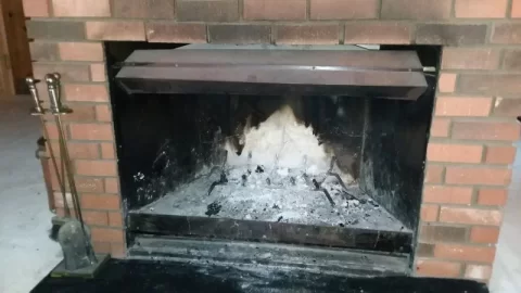

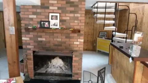

My house has a zero-clearance manufactured fireplace in the main living area of the house, which is in the basement. (I attached some pictures.) The fireplace is enclosed in plywood with a faux brick covering. The opening is about 42" by 31". My house was built in 1908, but I think the fireplace was installed in the 1970s. The inspector when we bought the house and chimney sweep said it's up to code.

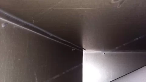

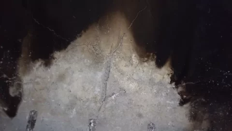

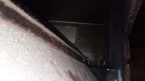

That z.c. has been badly modified. It no longer looks safe to burn in or to put an insert in.

It doesnt look right at all to me is the id tag still in it? If so what is the make and model
Most of the UL listed "zero clearance" fireplaces are listed as a system, and only components tested in the original listing are approved for use. That means that most, if not all wood stove inserts cannot be used. One of the problems is that if you block the ventilation openings between the firebox and the outer shell of the fireplace in the course of installing the insert, it can result in the outer shell overheating and starting a fire. You may want to consider tearing it all out and replacing it with a woodstove and insulated flue, with proper clearances to combustible surfaces.

I think if I find an insert that would work, ultimately it won't be that great of a setup. I think you're right in that I should put in a woodstove. Thank you all for your assistance! I got the information I need. Since many woodstoves have holes for fresh air kits, I'm going to put one in the floor in the bathroom above when we gut the room later this month.
