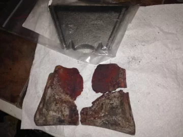

This Harman Advance Flame Guide went bad very quick on it's 6th year! Hmm!
Has anyone else had this issue?
Click Pic to enlarge
  • [Hearth.com] Friendly Reminder - Replace your Harman Flame Guide before it looks like this one!
Did the owner contact you and say, "I got clinkers, BAD"?
Wow! Mine is in it's 7th year and not showing any signs of decay. I'll have to give mine a closer inspection the next time I shut it down. Thanks for the heads up.
Mine is 20 years old and other than some minor pitting still looks good. Must have been a bad batch?
Original from 2003 still looking good. I wonder is corn or other alternatives could contribute to decay.
